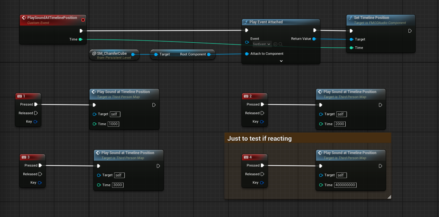

I’ve been testing SetTimelinePosition in Unreal with FMOD, but it doesn’t seem to react at all. No matter what value I pass, the event always starts from the beginning instead of jumping to the desired timeline position.
Here’s how I tested it:
Created a custom event that plays an FMOD event attached to a component.
Immediately after, I call SetTimelinePosition with different time values (e.g. 1000, 2000, 3000 ms).
You can see in the screenshots that I set up different input keys to test specific positions.
But the result is always the same: the playback starts from 0:00 and ignores the timeline position.
Screenshots:
Has anyone else run into this? Is there a known limitation or workaround?
