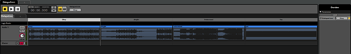

And here’s my FMOD setup for the event example:

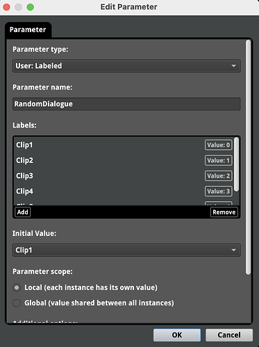

And the parameter setup:
I’m very nearly there, I think, but I’m getting a compile error from the script, saying "Argument 2: cannot convert from ‘string’ to ‘float’. I’ve tried putting each of the clips into quotations (e.g: if (randomDiaTrig == 1) dialogueInstance.setParameterByID(randomDialogueID, “Clip1”); ) but that generates the same error. I also just tried copying the exact code provided in the example link above, but that generated the same error, so not sure what I’m doing wrong…
Studio::EventInstance::setParameterByID expects a float value, not a parameter value label - if you wish to set a parameter using a label, you can use Studio::EventInstance::setParameterByIDWithLabel.
Mmkay, that got the console error to clear, but I’m still not getting the parameter to communicate from the script to FMOD. The closed captions are responding to the randomDiaTrig integer, but the FMOD event is not. Here’s the current FMOD setup for the event and parameter:
Oh yes, one modification I made to the script in troubleshooting was that I removed the series of If Statements out of the Awake() since I realized that as the script is attached to multiple objects, that should be called on at the time of interaction instead of the awake.
I also tried again with alternating between putting the Clip# strings in quotations or not - not having the quotations didn’t generate any console errors, but it crashes Unity when I play the level and pickup one of the keys. Having the quotations doesn’t crash it, but it doesn’t switch the parameter, either.
The crashing issue I mentioned in my last post appears to have resulted from a corruption in the .cs file. I started the script over from scratch, and that fixed it, but it’s still not communicating the parameter change from Unity into FMOD.
I also tried using the integer in place of the strings:
dialogueInstance.setParameterByID(randomDialogueID, randomDiaTrig);
But that didn’t yield any different result.

Ah, ok. I think I know what’s the discrepancy here. First, let me back up a bit.
In a separate forum thread (Overlapping Dialogue Interactions), I worked out with another user a technique he had developed for preventing interactive dialogue cues from overlapping unnaturally. This technique has the dialogue clips run as an EventReference instead of an EventInstance (the code narratorController.Play(collectedDialogue, SFXConcurrencyStrategy.Wait); in the last script I shared) which runs it through a concurrency script to determine if another dialogue clip is currently running, and if so how it should be handled (cancel, wait, stop current, etc.).
So, I gather that since the event is being triggered by an EventReference instead of an EventInstance, that’s why the parameter isn’t being triggered (I ran into a similar issue with trying to pause the EventReference cues in the case of the Pause Menu being loaded mid-dialogue, but ultimately decided it wasn’t worth wasting my time on figuring a way around that for only a few seconds of dialogue).
I just attempted to see if I could start the EventInstance and the EventReference simultaneously, but that of course just resulted in the clip playing twice.
I tested taking it off of the EventReference, and passed it through as an EventInstance instead, and that did work, so this definitely seems to be the issue. I also tried starting the EventInstance and immediately stopping it, then letting the EventReference play, but that didn’t work either - the clip played, and didn’t double up, but the parameter switch didn’t hold over into the Event Reference (didn’t think it would, but it was worth a shot, lol).
Is there a way to pass the parameter trigger through to an EventReference, as you would with an EventInstance, or do I need to essentially choose between having my dialogue overlap and having the captions synch up?
What you’ve described would definitely explain the behavior you’re observing.
The short answer is “no”.
The long answer is that it appears you may be confused about what exactly an EventReference is, what it “triggers”, etc., as well as the scope on which parameters exist. I suspect some of this confusion is caused by the code that actually plays an event being in NarratorController instead of directly in CollectKeys.
An EventInstance is an instance of an event you’ve authored in FMOD Studio that has been created by the FMOD System. it can be played, paused, stopped, have parameter values set on it, etc.
An EventReference, on the other hand, is a convenience class in the Unity plugin that essentially just stores the path and GUID of an event to make it easier for you to create instances of the event. You can view the entirety of the source code for it at ./Assets/Plugins/FMOD/src/EventReference.cs.
It is not possible to set the parameters of an EventReference, because an EventReference has no parameters. It is possible to set parameters of an EventInstance. However, unless your parameter is “global”, it exists on a per-EventInstance basis, so setting the value of a parameter on one EventInstance will not affect another EventInstance.
No, it’s entirely possible to do both. From what I can tell from the thread you’ve linked, NarratorController would require a couple of tweaks to handle it. The simplest way to do this would be to have a member of NarratorController that represents the desired parameter value, and then make sure to set the parameter to it in NarratorController.PlayNow() before calling _instance.start(). For example:
