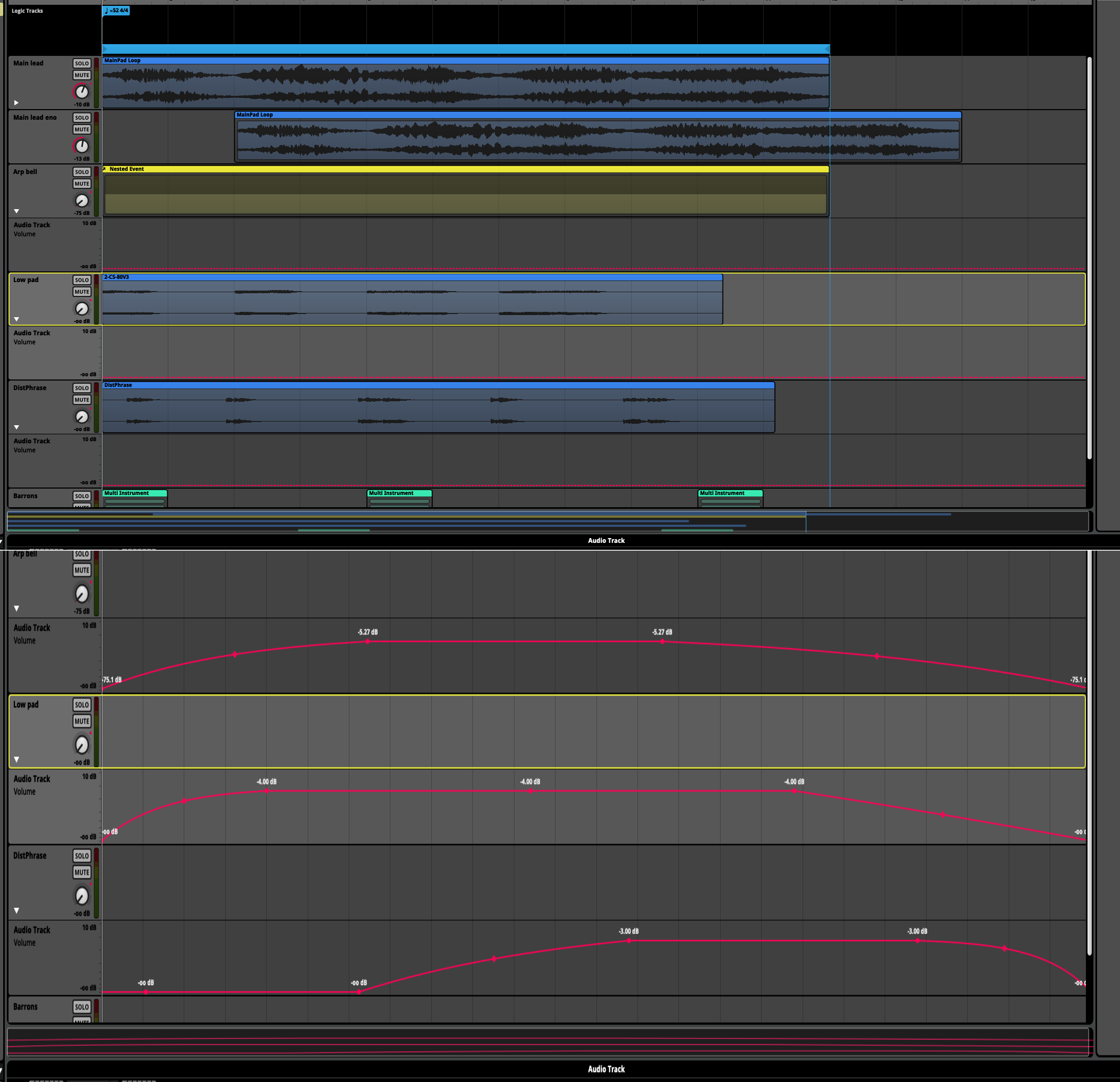

As an example, variable automation points would be useful with vertical music setups. I can create a variation to the fade in/out points by duplicating the tracks to a new loop range but if I could randomly move the automation points that would just simplify the process and allow for increased randomisation.
I’ve also added your suggestion that we support modulation of automation point y-values to our feature/improvement tracker.
