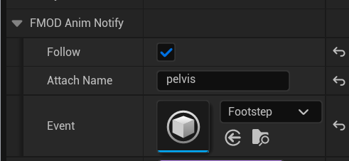

Actually it plays with default settings, but it fails when it’s attached to bone.
Thank you for the clarification!
This is actually a known issue, and the fix is currently scheduled for out next release of 2.03.
In the meantime, there’s a temporary workaround available here:
Animation Preview No Longer Works (2.03.08 - 5.5) - #8 by Leah_FMOD
