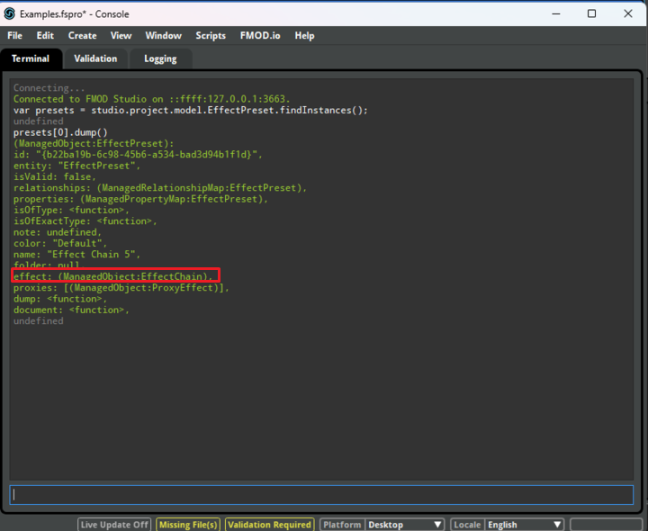

@li_fmod Something that has also come up is that is that studio.project.model.EffectPreset.findInstances(); is returning both effect preset parameters and effect chains. It also returns if they are folders.
How can i distinguish between all of these types?
A solution may be to use the effect property to filter out the desired object

Unfortunately that didnt work as preset parameters also return “effect: (ManagedObject:EffectChain)” which seems a bit weird to me.
Ive gone through the dump and cant seem to find anything that indicates a distinction between parameters and effect chains. But i may be missing something.

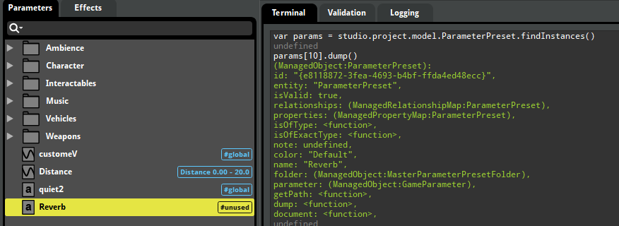

Would it be possible to further elaborate on what parameters refers to? If you are referring to parameter preset, it can only be returned by studio.project.model.ParameterPreset.findInstances()

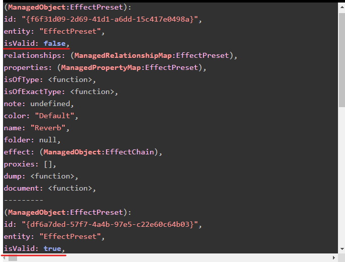

Okay so this may actually be a bug in Studio v2.02.20 then cause when i call this it returns parameters and folders as well:
var presets = studio.project.model.EffectPreset.findInstances();
presets.forEach(function (preset){
if(preset.name == "Reverb" && preset.effect == "(ManagedObject:EffectChain)"){
 preset.dump();
 console.log("---------");

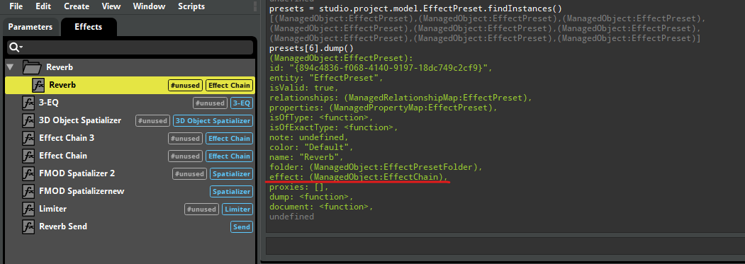

These are the only presets and effects chains/folders called “Reverb” in my project, as you can see in my presets window:
As you can see, There is 1 parameter, 1 Effect Chain, and 1 folder that the effect chain is a child of that are all called Reverb. I would expect with what you suggested above that this code should only return the Effect Chain called Reverb.
However this is the log that gets returned:

Thank you for sharing the code and logs.
I think I have identified the issue in the logs. The 3 returned Reverb objects from the logs are all EffectChain presets, however, they are not all valid. You can confirm this by checking the isValid property FMOD Studio | 24. Scripting API Reference | Project.ManagedObject | ManagedObject.isValid
Could you please try adding an additional check : preset.isValid == true to see if the issue persists?
if(preset.name == "Reverb" && preset.effect == "(ManagedObject:EffectChain)" && preset.isValid == true){
preset.dump();
Alternatively, if you close, reopen FMOD studio, there should be no more invalid objects in the log.
Oh i get it now - apologies, my assumptions were off but it so happened that my methodology led me to believe the parameter and folder were being considered to be effect chains, whereas actually what it was was that the Reverb effect chains that i had removed from the event were still hanging around but werent valid as i assume they hadnt been cleaned up or something :slight_smile:
Adding the isValid check fixes this issue! Thanks so much for this - it would have taken me ages to figure that out on my own. That should be everything for now but ill be in touch if anything else comes up!
