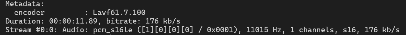

Hi! Apologies for the late response - I don’t think I am able to provide these files publicly, but I can show details of the file.
This is one of the problem wav files:
This has actually been converted from a Playstation 2 .vag file using FFMPEG.
I don’t have a great deal of experience with audio, so I may have missed something fairly obvious here - I appreciate the help.
Something I’ve actually noticed is that multiple files that I am trying to build into the same .FSB do have different sample rates.
For example,
File 1 - 22042 Hz
File 2 - 11015 Hz
File 3 - 24000 Hz
