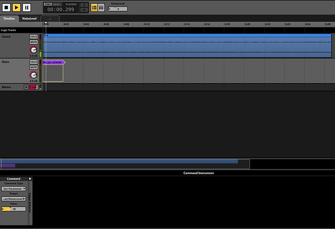

Here is a screenshot of my event in FMOD
Thank you for sharing the code and information!
This behavior sounds expected.
Commands issued by Command Instruments are not processed instantly, but only take effect after the next FMOD Studio update tick. That might explain why you’re getting zero values when reading the parameters in the same frame.
Could you please try calling Studio::EventInstance::setParameterByName right after your CreateInstance() to see if it gets the correct value instantly.
