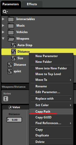

I noticed that in FMOD it is not possible to create parameters with the same name, but it is possible to have parameters with the same name in different folders.
For this situation, how should I get a parameter with a specific name?
QQ截图20240517151715
In FMOD, when dealing with parameters that may have the same name but are organized in different folders or banks, we would recommend to specify the full path to the parameter to ensure that you’re accessing the correct one.
Here is how you can do that:
Right click a parameter => Copy Path
Then you can call Studio::EventInstance::getParameterByName and pass in the full path to get a parameter with a specific name.
