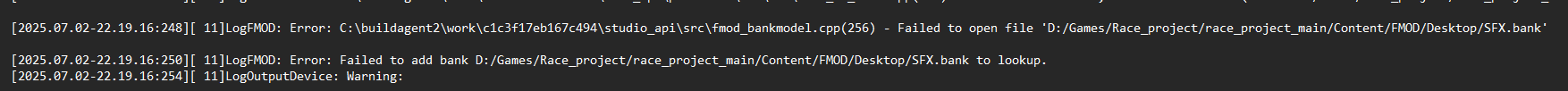

I think I’ve solved the problem for myself. After analyzing the log file after the UE crash, I found that the engine crashes on the build of only one bank. Apparently, when updating the project, one of the banks was damaged, in my case SFX.bank. I deleted this bank from the engine and rebuilt it, which solved the problem. Look in the log file for which bank your engine breaks. I hope this helps someone :slight_smile:

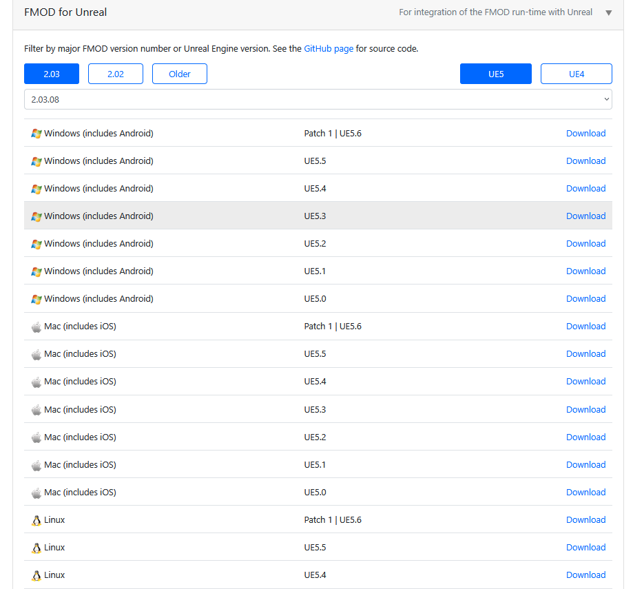

We have released a patched version with a temporary fix, while we wait for Unreal to determine a fix on their side we can investigate a more permanent solution.
