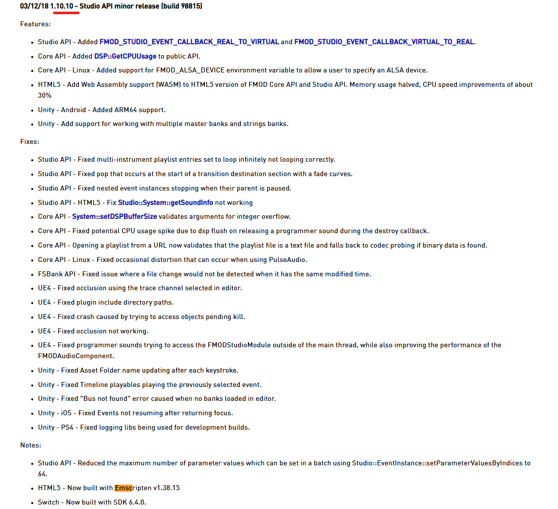

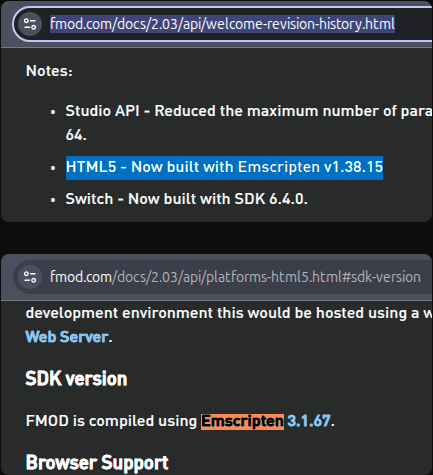

What emscripten version is in 2.03.09?
I think I found conflicting information, or am I getting it wrong?
Thank you for sharing the screenshots!
The emscripten version used in 2.03.09 is 3.1.67.
The reference you found mentioning v1.38.15 is from the much older 1.10.10 release, quite a while back.
