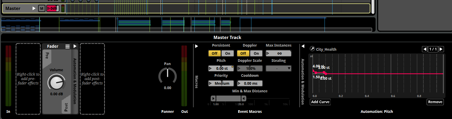

Absolutely! So, here are the two ways I’ve implemented it:
The first way is with a continuous parameter called City_Health that goes from 0-1, 1 being full health, and 0 being 0 health. I’ve used the parameter as a curve on the Master track’s Pitch property- it’s pretty small and kinda hard to see, but at 0.1 the pitch goes up a bit, and then it does so again right when we’re close to 0.
