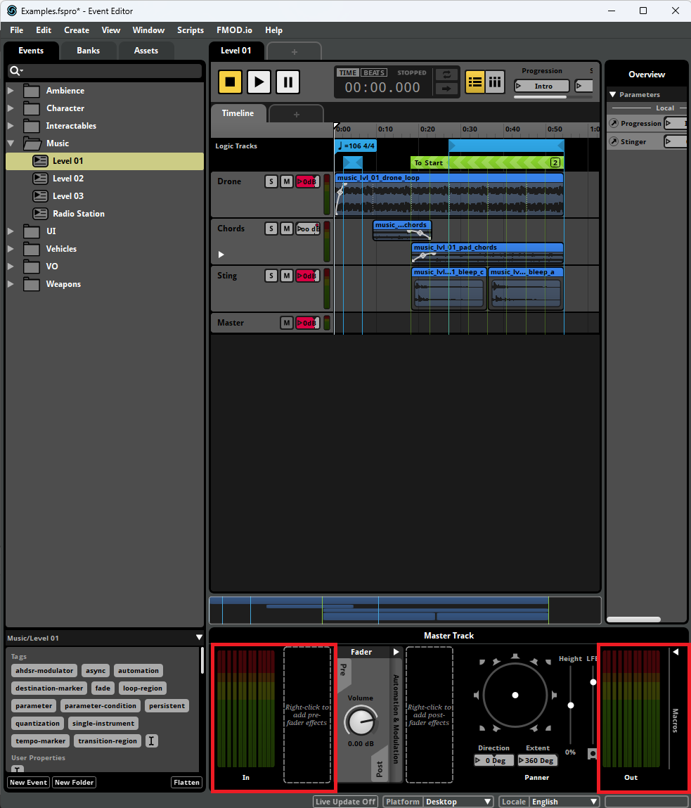

Please ensure your build options are set to 7.1 in your preferences:
The events out is set to 7.1.4
And the master bus in and out are set to 7.1.4
One of these settings may be missing downmixing the output when building the banks.
Let me know if this helps!

Thank you for the information. Apologies, I could have been more clear.
All of these settings are in FMOD Studio. The Project Platform Preferences can be accessed through the Edit drop-down menu on Windows:
The event mixing can be found here:
