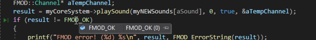

Debug:
fmod error working 1
Release:
fmod error null 1

As the images above show, creating a channel inside of my own “Play 3D Sound” Function has thus far been working flawlessly in Debug mode, the sound plays in the correct position, etc etc.
However as soon as we started switching to Release, the function now suddenly returns NULL on the channel handle, rather than…whatever 0xcccccccc is. Normally I create a temporary channel, define it with playsound and then set its position in the world to play properly, but in Release, it returning null results in it never being set Post play-sound, and results in a crash.

Playsound returns FMOD_OK correctly in visual studio’s debug.
However in its Release mode, since aTempChannel becomes null and remains as null, it returns an error-handle.
Here’s an image of my entire function, which uses Playsound.
There’s some things related to position and such which can be ignored, the main issue is tied to FMOD::Channel* aTempChannel, and the playSound call below it.

That result indicates that one of your parameters was invalid, most likely there’s a bad value in that array. So things to check would be:
  • What values are in the myNEWSounds array
  • What is the value of aSound
  • Is the value of aSound less than the length of the array
  • What is the value of myNEWSounds at index aSound.

Since my last post, I’ve realized that not only does this playsound not work, but everything just seems to have broken completely in Release mode. My entire NEWSounds array, and all of its assigned sounds are NULL.
Despite things still working flawlessly in Debug.
The values themselves are correct though. aSound’s assigned value is 19, which is the sound I called for. And the size of NewSounds is 23, which is also correct to the amount of sounds loaded. The value of aSound also doesnt exceed the length of the array or anything like that.

That narrows it down a bit more and explains the crash. How/where are you populating this array of sounds?
I managed to solve it! And of course the issue was way simpler than I had thought.
In my LoadSounds function, there was indeed a “ifdef debug” line present, I had just assumed that it wasn’t affecting anything, since it never caused a crash there.
