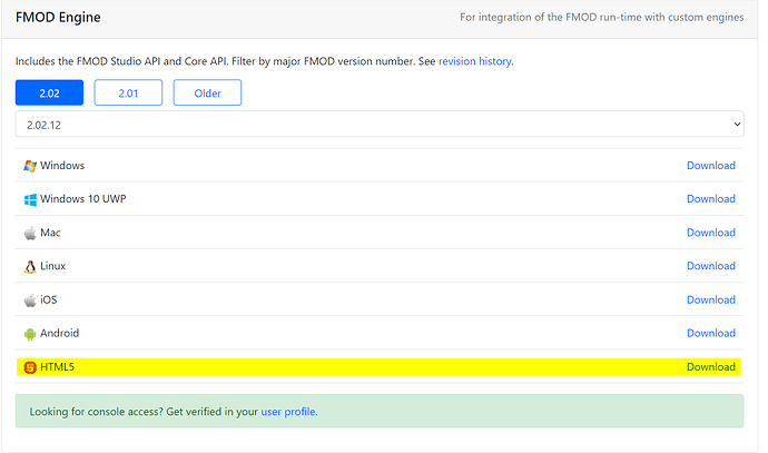

I had deleted from my project but I just downloaded the HTML5 example again to test:
I printed paramterDesc.flags to the console log using the below, starting line 158, I added lines 164 and 165:
