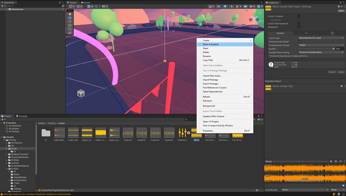

Is it possible to get a screenshot of what you are seeing when you are right-clicking the Music object in the Unity Project window like this:
What error are you getting when trying to drop the mp3 onto the event?

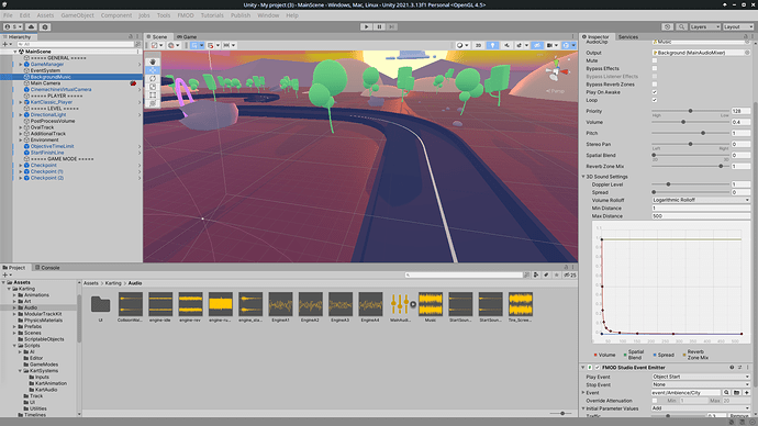

How do you manage to take a screenshot with this menu displayed? I cannot. If displayed, the key won’t take the screenshot, and as soon as i press a a key or click elsewhere, the menu disapear… But it’s the same menu, apart from the absence of ‘show in explorer’. Can only show you the screenshot without the menu…
And the mp3 files simply won’t enter the timeline, they’re just gettin back to their folder in my music directory.

For Windows: on the music file Right click > Show in Explorer
For macOS: on the music file Command-click > Show in Finder
For Linux: on the music file Right click > Open Containing Folder
For adding files there is another method: File > Import Assets which will open an operating-specific file picker. Navigate to the folder containing the Music file and import it. This will add the file to your Asset Browser:
Which you should then be able to drag and drop onto your event:
And the drag the instrument all the way left to the start of the timeline.
Yep, openin container on linux… Okokok, worked by importin the asset in FMOD. Dunno why i cannot drag the mp3 from elsewhere.
