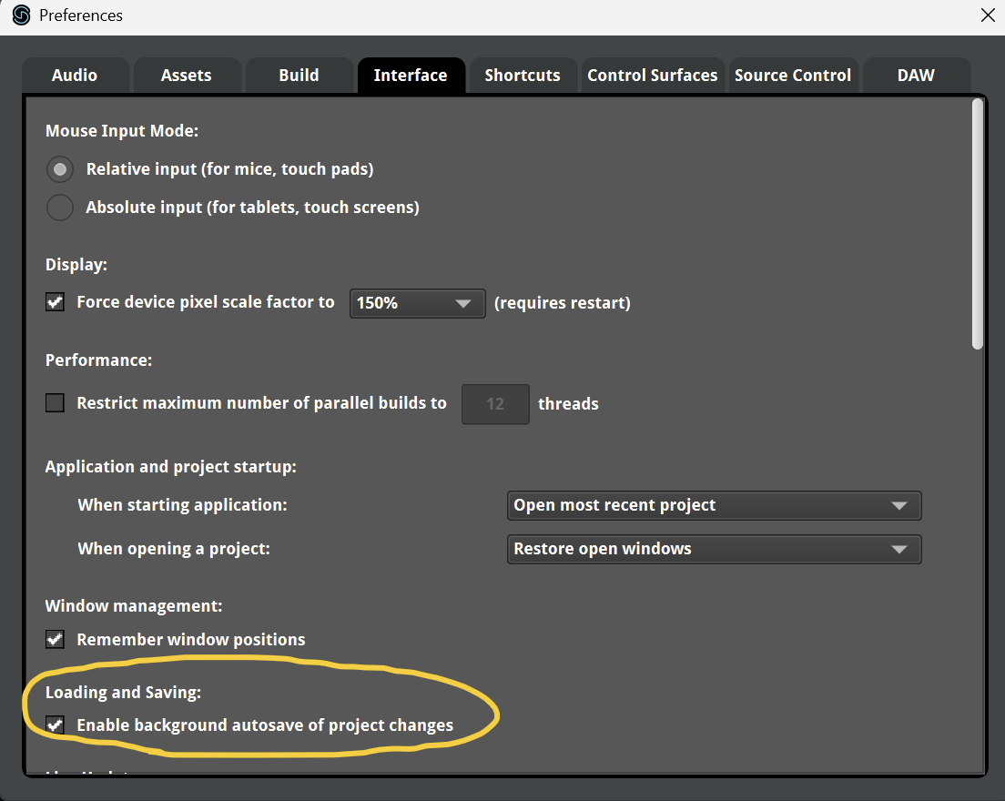

The problem was in the fact that the project was located on an external HDD and this particular option in the settings was causing it.
Thank you for sharing the solution!
