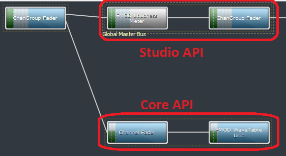

Thank you for the screenshot.
When you create a Sound with the Core API it will not be part of the Studio API master bus shown here using the FMOD Core Profiler:
image.
An alternative solution would be using a Programmer instrument to play the audio file instead. We have a scripting example using a programmer instrument to play an audio file from an Audio Table: Unity Integration | Scripting Examples: Programmer Sounds.

As the programmer sound is created as part of the Studio API you should be able to control its volume through Live Update.
Yep, this ended up working for me. Faffed w/ it a bit to fit my needs. Thanks for the pointer.
