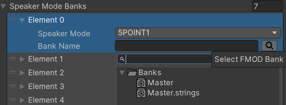

Right now for the bank names I have a [FMODUnity.BankRef] public string BankName; to grab the name of the loaded banks and it’s only option is the projects Master bank, so that is not giving me a bank for the different speaker-targeted builds.

Our project was already built out with the meta files separated, and it’s split into 3 folders; Stereo, 7.1 and 5.1 in the attached example if you want to see how the bank names and meta files built out. We are using the[FMODUnity.BankRef]attribute to get the names of the banks in the project (the only ones that show up are Master and Master.strings). So it appears we are building the project out as suggested, but I am unclear on how the actual loading/unloading from one set of banks to the other will work via code.
(Bank/meta file set up for Stereo/7.1/5.1)
(Attempt to get bank names; the plan was to pass this value into a.LoadBanks(bankName); call)

I am able to see all my loaded banks:

Very strange, Master is still the only bank I can see when using [FMODUnity.BankRef]
And still don’t quite understand the given example. Say we have to load 5.1 ‘Master’ bank vs. a 7.1 ‘Master’ bank. We’re passing ‘Master’ to LoadBank() within the unity editor. I understand the #else clause that loads directly via path; I’m misunderstanding how the #if UNITY_EDITOR portion would work given that we are passing the same Bank name. Unless the idea is that the different platform folders would produce a different string when referenced with [FMODUnity.BankRef].
