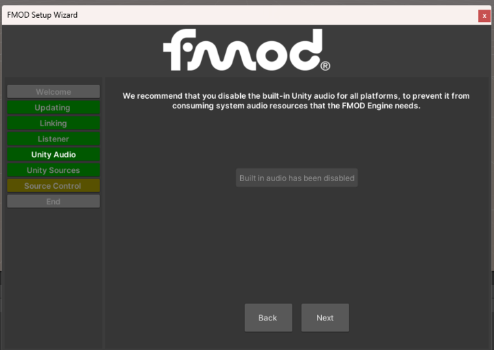

What FMOD Unity integration version are you using? Is this a released project?
Could I grab some information about your current setup? From the code you provided, it seems like you might be using both the FMOD system and Unity’s built-in system, which might be causing the issue with initializing FMOD. If that’s the case, would it be possible to disable the built in audio to see if the issue persists?
