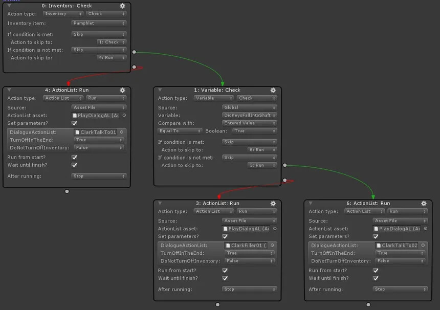

AdventureCreator (forward as AC) is a 2D Point and Click Unity plugin that has a built-in node system, similar to the default unity’s animator. This AC node system is called “ActionList”, which contain different actions inside connected with nodes to make things happen in the game. ActionLists are a component you can place in a gameobject.
This could be one ActionList with different actions inside (i searched one image in google).
AC allows you to create custom Actions (those windows) deriving from the AC class “AC.Action”, which derive from ScriptableObject primarily. It is like a “CustomEditor” but you are not provided with the parameters of a custom editor (serialized property, position, etc…), and even the same AC gives their own functions to generate each GUI that unity gives by default (Sliders, Toggles, Buttons…).
