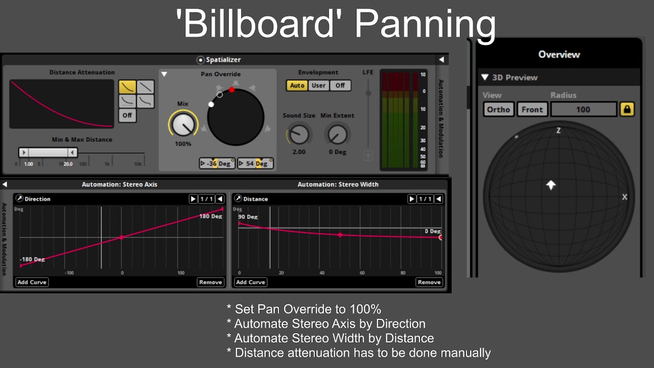

One way to achieve this now, before the feature is implemented, is to use “billboard panning”, ie set the Spatializer to 100% mix override with L/R Stereo, and automate the surround axis and width by Direction and Distance.
Video:
Thanks for the trick, I’ll try that!

Three years later and this thread came up when I searched the same issue. I’m on 2.02.19 and I’m not sure if this feature was ever added in or prioritized but the “billboard panning” suggestion results in the behavior I’m after – but just wanted to add my voice to this feature request as the stereo fold down is jarring
