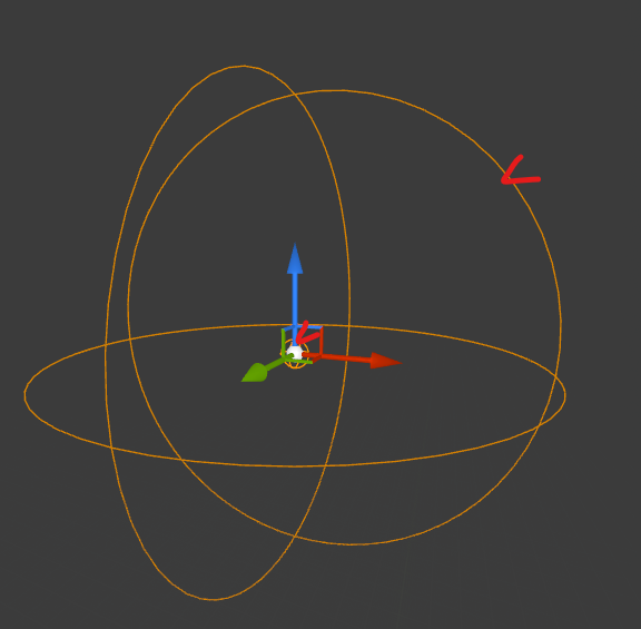

Spatializer Override Min & Max Distance values cannot review on UE - UE5.7.1 with FMOD 2.03.11
I found a bug with Unreal integration - UE5.7.1 with FMOD 2.03.11
When I change Distance override values,
These gizmo is not changed.
But sound is changed.
When I change Event Macros Min & Max distance values,
gizmos have been changed.
When we use Distance override, we cannot preview this distance visually.

Currently this is the expected behavior, if ‘override’ is enabled on the spatializer then it will override the distance values from the event macros and this is what the integration uses for setting attenuation and drawing the gizmos.
Although we have a task to make getMinMaxDistance also use the override from the spatializer but it likely won’t be added to 2.03.
