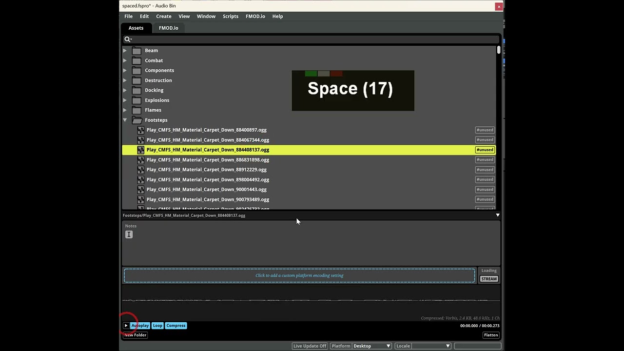

I recorded a video that also shows my keypresses. I’m not aware of doing anything more than I described, but this way you can see if I’m missing something:
Thanks for the video! It seems that spacebar does work for auditioning assets in the assets browser found in the assets browser window, while I was only testing in the assets browser found in the event editor window. That explains the discrepancy. Sorry for the confusion.
