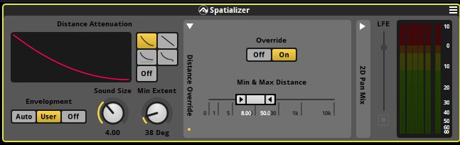

Hi, I’m trying to get a handle on unit conversion between Fmod and UE and am a bit confused by what I’m hearing. I have an 3D event set like this:
And in UE the event volume goes to about zero when the distance between listener and Fmod component is 500. This leads me to think the conversion is 1/10 but that doesn’t correlate with what I’ve read elsewhere (1/100). What have I got wrong here?

The overrides set in the editor will not take effect if the Distance override has been set on the events spatializer.
