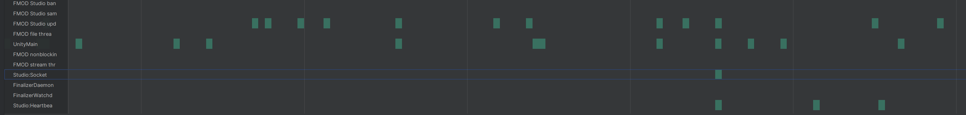

Looking at the profiler in the Android Studio, the process is sleeping, but there are a few active threads running, which most probably dont let the app finally quit, namely - FMOD Studio Update, Studio Socket and Studio.Heartbeat
