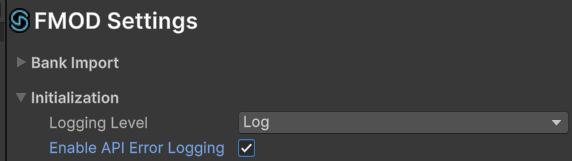

With the following settings enabled:
Are there any FMOD errors in the console?
Most FMOD functions return FMOD Engine | Core Api Common - Fmod::Result, are you able to log those through Play Maker? In your DoSetParameter() can we add FMOD.RESULT result = eventInstance.SetParameterByName()and log the results of those calls too?
