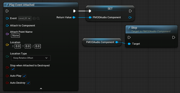

      • With the bAutoDestory enabled the event instance attached to the FMODAudioComponent needs to be stopped for it to be destroyed. I would suggest promoting the returned value from Play Event Attached to then call stop when the object is returned to the pool:
        This way we are sure the component it is creating will be destroyed.
