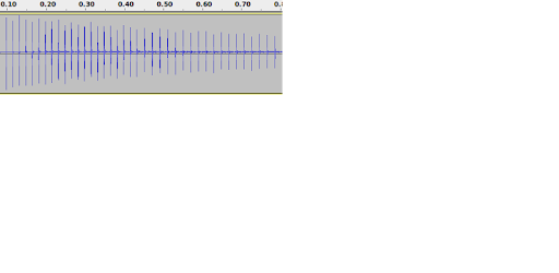

hi,
im using this app :
from the play store…
or you can find the source code in github:
another thing, in call im not having a bluetooth latency over voice,
so maybe its not the phone latency is fault.
check it out and let me know…
thanks,
tal
For best results we recommend to use AudioTrack with the default buffer settings for bluetooth audio.
The OpenSL Low Latency mode is only available on certain hardware and software configurations, using bluetooth will automatically disable this mode.
