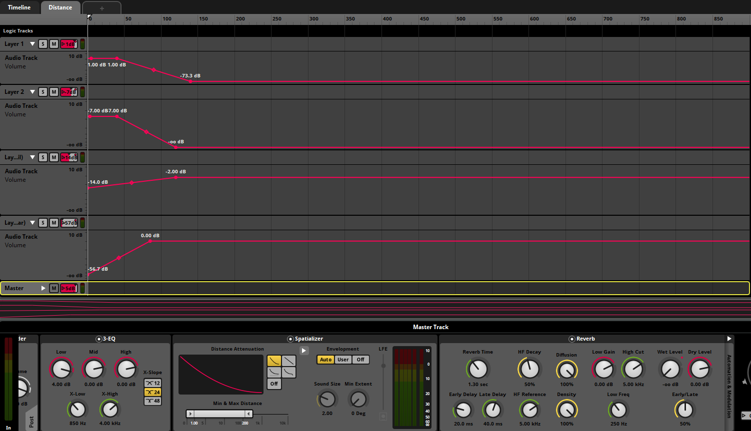

This screenshot shows how the attenuation is set for the sound we’re testing:
The reverb’s wet level is also automated to increase with the distance. What we can hear is that the sound plays the same from 0 to more or less 100 units of distance. Then, it does change and decreses in volume a bit and has some reverb to it but the levels don’t change at all until the 200 units distance is reached. After 200 it can’t be heard at all. So there’s a spot where you can hear it clearly, and one unit after, not at all.

The culprit may simply be the reverb wet level automation, which compensates the spatializer attenuation. Bypass the reverb to check that point.
By the way, have you tested your event 3D behavior in the overview pannel?
The 3D preview? Yes, and it behaves very differently than it does in gameplay. I don’t think the reverb is the problem, because of this
The next step would be to do a live update session, to visualise in FMOD Studio what’s going on (event coordinates, parameter values…)
