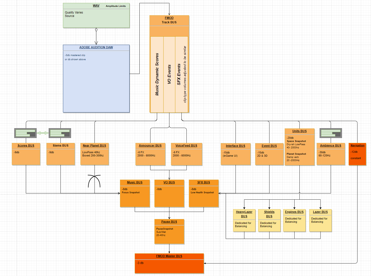

Heres a rough schematic of how our audio is setup. it does not include all separated sound effects to their unique busses, but gives an indication of some.

Having a bus for each category of sound, is a perfectly normal and efficient workflow.

Yes, you could automate the reverb with a parameter. Also think about using the reverb on a mixer return, instead of individual tracks/events, if you have several events to send to it. You’ll save some CPU. In that case, the automation can be with a snapshot.
(I’ll check your diagram later)

As alcibiade says, routing events into group buses so that you can manipulate those events as a group is standard practice. In fact, it’s what group buses are for: Because of the way the mixer is designed, it’s usually cheaper in resources to put an effect on a group bus than to put it on each of the individual events routed into that group bus.
