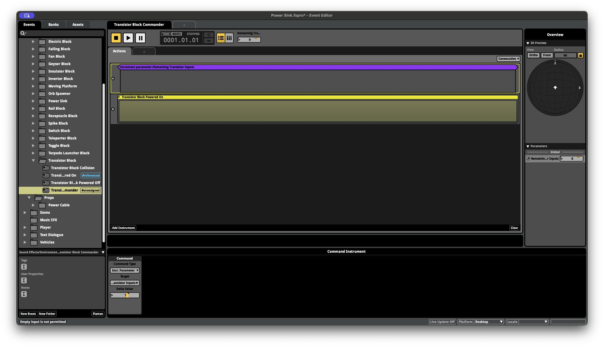

I have a set of five sounds (beeps) that I want to play in order, ascending and descending based on a discrete parameter named ‘Remaining Inputs’ with a range of 0 - 5. When there are certain number of remaining inputs, the beep played should correspond to that number i.e. with 3 inputs left the 3rd beep in order should play. Here’s how I’ve currently set this up:
I initially tried creating a seperate even with an Action Sheet using a command instrument to increment the parameter and an event instrument to play the sound like so:
This didn’t work as expected, however, as the sounds seem to double up. Using a command instrument seems to be the way to go, but maybe I’m missing something?
I’ve also tried placing the common instrument inside the event where the sounds are played. It actually does properly increment/decrement, but plays both the current sound and next sound at the same time.
Also, when decrementing by -1 it seems to actually decrement by -2, skipping over sounds.
