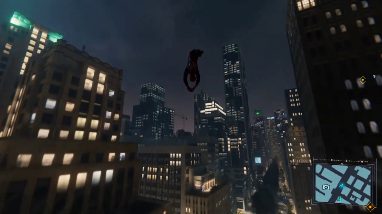

I’ve seen a similar approach used in Spider-Man for PS4:
It’s not exactly the same thing because there’s no layering involved here (actually not even a loop 1, it starts directly with the “transition”), but the same concept applies since there is some calculation needed to be done in order to make the the musical climax match the sweeping when Spiderman almost reaches the street (or it could be just a coincidence).

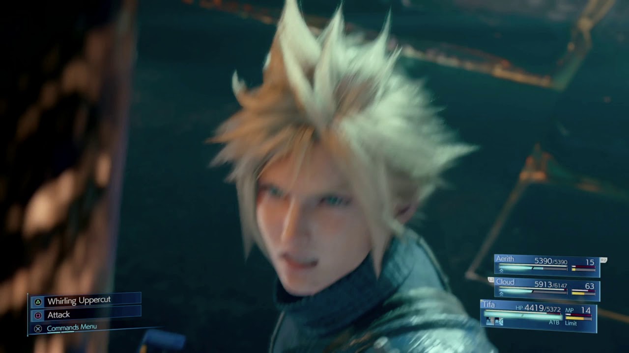

I have however an example of a music system that does everything phenomenally well, except maybe handling transitions. I mean, they work fine and with SFXs and dialogues on top it’s not super noticeable… but I noticed :laughing: Don’t get me wrong, I love this game to bits and the work they’ve done with the music is stellar (both composition and implementation), but it could have been even better.
Every boss in the game has multiple phases with pretty much the same classic pattern:
[loop1] -transition-> [loop2] -transition-> [loop3] -transition-> [ending cutscene]
Being a music only gameplay you can immediately tell the “problem” between sections, especially between loop 2 and 3. This one’s not even that bad, but I played tens of hours and I can guarantee you that there are many occasions where, if you don’t trigger the transition at an optimal time, there would be a clash with the previous section and it will sound wrong.
The only solution is to write custom transitions that serve as bridge in the most musical way possible. No abrupt cuts in the melody, no weird cadences, no clashes in the harmony, no interruptions in the instrumentation, no sudden jumps in dynamics, no rhythmic fills after one bar or less during 2-bar phrases, etc. At the very least it should be done whenever there’s a big change in mode/tonality, because when you suddenly come back that’s the first thing that the ear notices.
Because this would inevitably take a long time to plan and execute, I would probably keep it just for the most salient parts of the game. But it would be a great challenge for a composer and maybe someone could even come up with ways to create a whole game around this idea.
