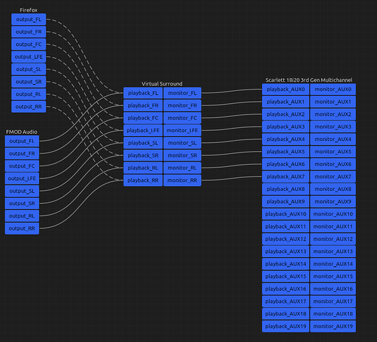

You should see it in the sound settings of your system like so:
  1. connect the outputs to your soundcard, for example with Helvum
  2. In FMOD project’s settings, use the corresponding channel map
  3. Set the surround speaker mode to 7.1 in the project platform
This solution does not persist after reboot, but you can easily launch a script to create the virtual sink on startup. You can automatically connect the outputs to your soundcard with pw-link if you’re using pipewire.
