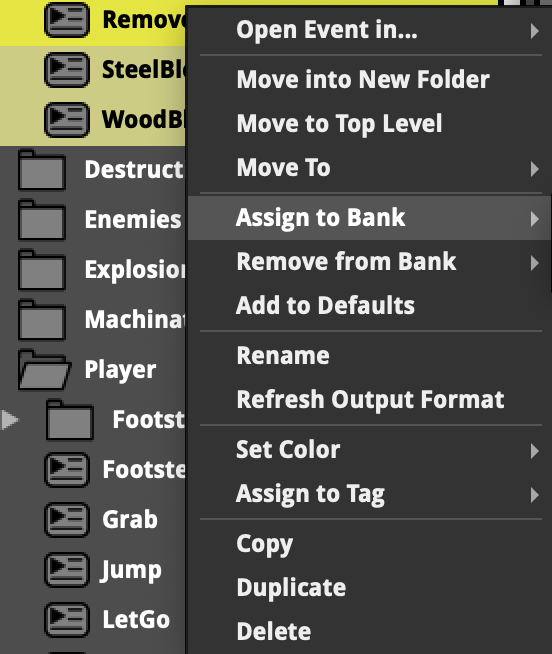

I want to figure out how to copy several event paths in one command. When I select more than one event, copy path vanishes on the right click menu, and all i am left with is Copy which takes both GUID and Path.
By looking into shortcuts I found copy path as a specific command yet when I try that with several events, it doesnt work, pasting afterwards gives me the previous copy I did, not the current one.
Below is an example of copying one event vs several.
As of the time of writing (September of 2025), FMOD Studio does not have any out-of-the-box way to copy the paths of multiple events without also copying their GUIDs.
