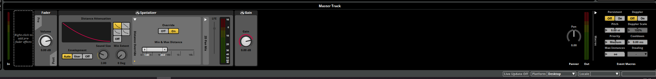

Here’s the event with a spatializer and gain effect, Override is active and the event Min/Max is not showing:
And here’s the same event only with a reference to the Direction parameter on the gain parameter:
As soon as there’s a reference to the Direction parameter it seems the Min/Max override is disabled.

in the version of FMOD Studio that you’re using, the min/max distance controls appearing in the event macro controls does not mean that spatializer’s override has stopped working. Rather, the min/max distance macro controls appear if the event contains either an effect that makes use of it or at least one built-in parameter. Since Direction is a built-in parameter, it causes the controls to appear. The spatializer is still using its own min/max distance controls, however, as it is still set to overside mode.
This does mean that the min/max distance controls in the event macro controls don’t actually do anything in your event. You can safely ignore them, if you want.
