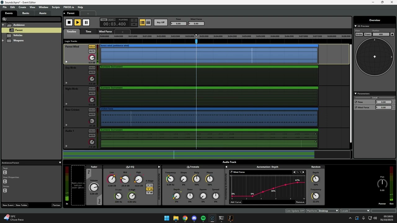

I’m creating a dynamic wind logic, where at the lowest level it is null and muffled, like a very soft noise, and at the highest level it is strong, loud, and oscillating.
So far I’m satisfied with all the logic I’ve built.
The problem now is that I need to randomize the wind frequency so that it behaves randomly just like in real life:
  • sometimes it stays very strong for a few seconds,
  • then it calms down a bit,
  • then it gets strong again,
  • stays in the middle range,
  • goes up, goes down – everything in a random way.
I tried every possible way to randomize frequency and duty (which seem to be the parameters responsible for what I need), but I didn’t get the expected result.
I’m satisfied with the depth, because I need it to increase as the wind gets stronger and stay at 0 to have a very soft idle sound.
How can I do this?
Please note:
  • I’m a beginner with the tool and don’t speak English, which makes it a bit hard to understand many terms here.
I would also be happy with suggestions on how to improve the project structure (for example, having added Tremolo as a post-effect after testing it as a pre-effect to see if there would be any change).
Thank you in advance!
