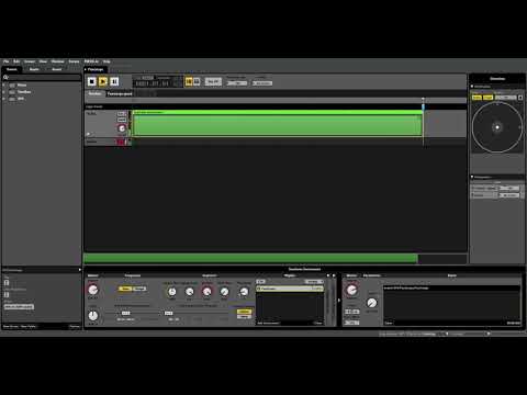

No, with a scatterer, the new shot can be spawned even if the previous isn’t finished. Here’s a video capture of one of my events (a variable speed footsteps loop) that works pretty similarly. I use a sustain point rather than a loop because I found that extremely reliable and responsive, and works really well to have the last sound played entirely before exiting. At the end, I show how you could add a tail sound that would trigger when exiting the loop.
Great, thanks, will have a look. Have had lots of problems with the scatterer cutting up audio in the past, but will try again:)
