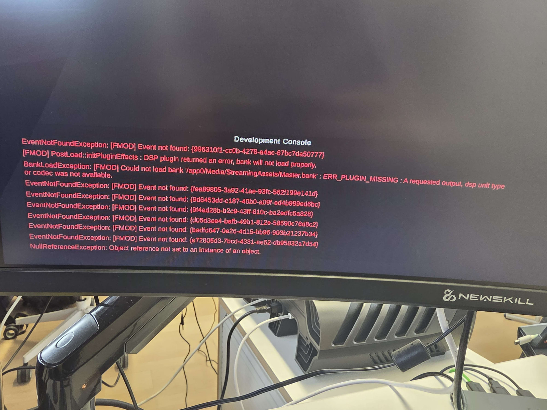

But if i leave the dynamic plugin empty FMOD generates the following error:
After all my tests, i can’t guess why FMOD does not find the dynamic plugin.

Thank you for sharing the information and screenshots.
fmodstudio is not a DSP plugin, but the FMOD Studio runtime library itself. Adding it as a dynamic plugin will cause FMOD to try to load it as a DSP plugin, which may result in errors like this.
This suggests that your banks are actually referencing a real dynamic plugin, which is currently not being loaded.
From your screenshots, I can see that your project includes: libresonanceaudio.prx
It is possible that your banks are using Resonance Audio, so you may want to try setting the dynamic plugin to: resonanceaudio
Let me know if the issue persists.
