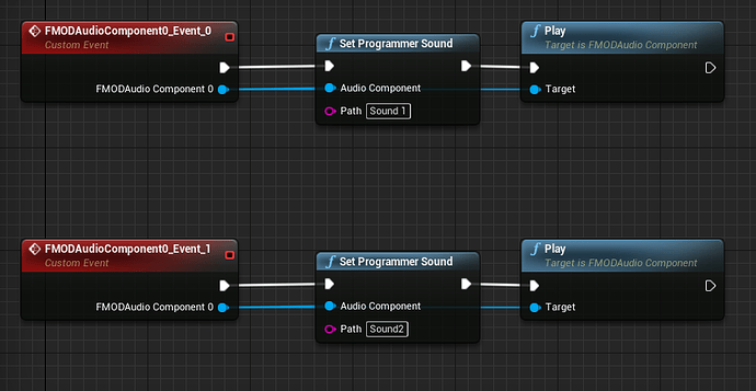

Here is the sequencer for example:
With these events calling the Set Programmer Sound and Play nodes on the audio component
