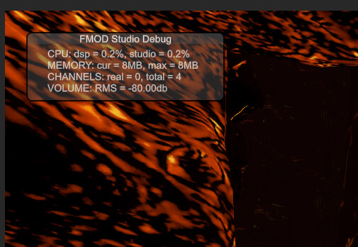

When I start the game, this is the read out I get every time. Real = 0 always, total = 4 always and VOLUME RMS always = -80.00db

You may have already checked this, but just want to double check something simple here in case it’s being overlooked.
Could you please check whether audio has been muted in Unity’s Game view? There is a Mute Audio toggle in the Game view toolbar that can mute all audio during Play Mode.
Specifically, the mute toggle here:
Oh my….how embarrassing haha. That was it!
Thank you so much.
