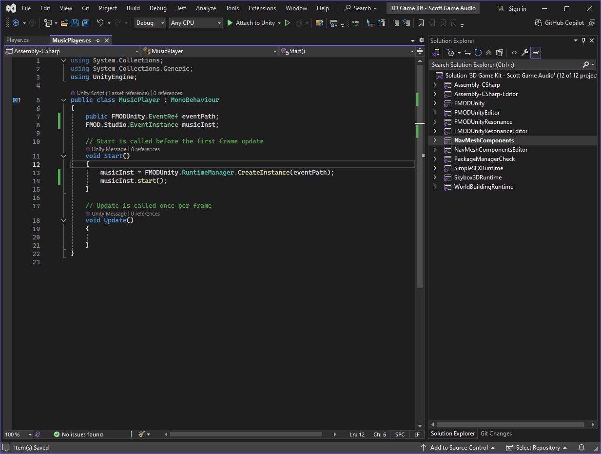

I tried to serialize a field for my FMOD event path in the Unity Inspector. As described in the current documentation, I used:
public FMODUnity.EventReference variableName;
I then got the error that FMODUnity.EventReference is missing from FMODUnity (CS0234). I solved that error by using:
public FMODUnity.EventRef variableName;
It works now, but I’m confused (total beginner here). I can’t find FMODUnity.EventRef in the FMOD Unity Scripting documentation on the website. Is that actually the solution?

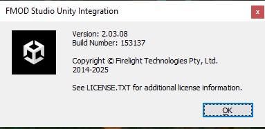

This is my FMOD Integration version: 2.03.08

Could I please confirm the exact version number of the FMOD Unity integration you’re using? You can find the information by navigating to FMOD => About Integration.

EventRef was made obsolete in FMOD 2.02, In FMOD Unity Integration 2.02 and above, the correct and fully supported way to reference FMOD events in Unity scripts is:
public FMODUnity.EventReference eventPath;
If you’re still encountering the CS0234 error when using EventReference, could you please double check the following:
  • Your FMOD Unity integration is correctly imported.
  • You’re using Unity 2020+ (some older versions might have trouble serializing newer structs)
  • You haven’t renamed or moved FMOD folders in a way that breaks namespace resolution

I double checked my FMOD Integration Version. It is 2.03.08
