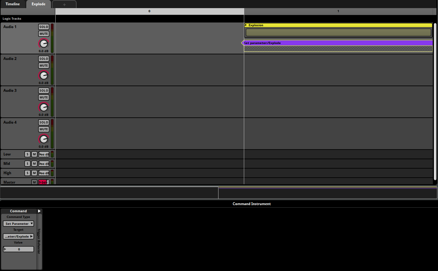

You can however setup sample accurate event scheduling in FMOD Studio using instrument Trigger Conditions and use parameters to trigger the instrument.
As an example, here is how you could setup an event to trigger a beat-quantized referenced event on a parameter change:
Add a parameter sheet to your music event, with a new discrete parameter ranging from 0 to 1.
Add a referenced event in the “1” section of the parameter sheet.
Configure the referenced event instrument to trigger on quarter notes.
Add a command instrument to immediately set your new parameter back to “0”.
With this setup, while the event is playing you could call EventInstance.setParameterByName("Explode", 1) and trigger a beat-quantized referenced event (in this case an explosion) on the next quarter beat.
