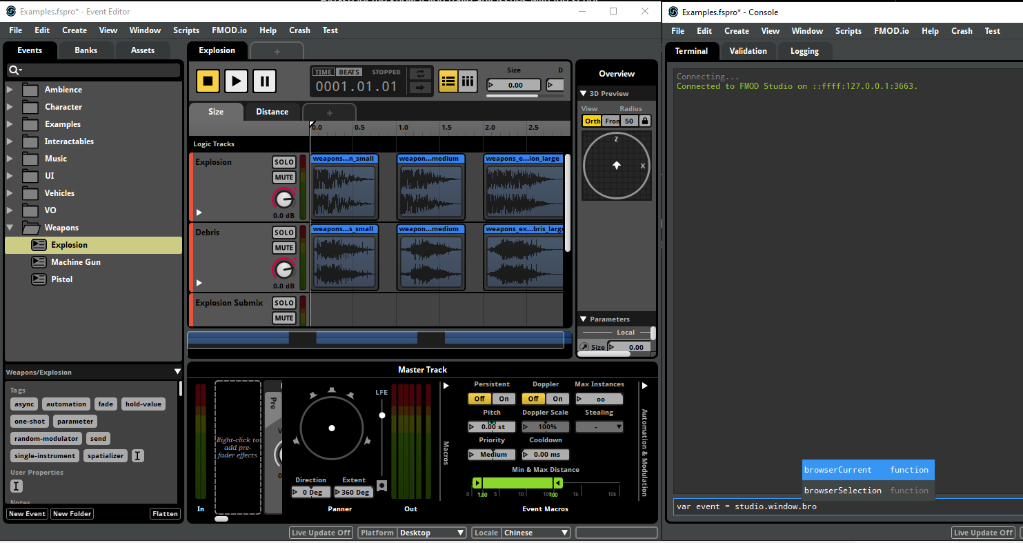

May I also ask if there’s some IDE where I can get autocomplete when writing scripts?
I will certainly pass it onto our development team to investigate further.
You are able to code directly in the FMOD console which does provide some auto completion:
Hope this helps
