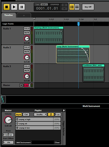

I have a laser pulse drill sound that I have in a Multi instrument, it contains the start up sound and then it loops the sustained sound until release of the mouse button which then triggers another event with the cooldown multi instrument.
My question is asking if i can achieve this in one event?
Is there an easy way to end the loop and trigger the cooldown sounds ?

Yes I can. How is set the main loop? Could you share a screenshot?
What I have in mind is something like this:
When you trigger “Key Off”, it goes seamlessly to the cooldown. But this assumes the multi playlist entries blend correctly together by themselves. If that’s not the case, you’ll have to setup a nested event.

I got the key off to show up but pressing key off does nothing and im not 100% how to get it to switch to the sustain point(cooldown sound)
Your setup is not correct, the playback is stuck in the loop and never reach the sustain point. Why don’t you try the way I showed you?
The nested event doesnt play anything when i press play.
Just to be clear: your parent event must be a new empty event, in which you drag/drop your actual event in it (it will be the “nested event” I’m talking about). Did you do this correctly?
Got it! Didnt know that step. Thank you!
