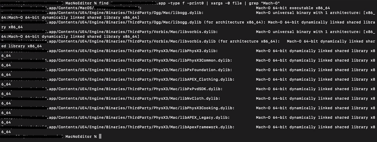

Hey @alexvvv1 ,
Were you able to resolve this? I am facing the same issue related to libtbb.dylib.
I have signed everything correctly, and the app is running in my machine however when i send it to app store and download it from testflight, it is throwing error (code signature invalid in <6C6BD7A4-4818-33BF-827E-22FE4ED15686> ‘…/UE/Engine/Binaries/ThirdParty/Intel/TBB/Mac/libtbb.dylib’ (errno=1) sliceOffset=0x00004000, codeBlobOffset=0x0003D250, codeBlobSize=0x000056B0)
