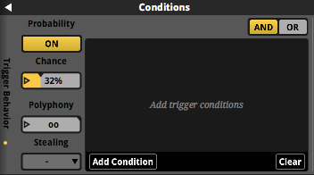

Thanks for the screenshot. How is configured your 30% probability and on which object? In which circumstances will a track play or not play?
What’s the purpose of all this event? Why is there fades in and out on looping tracks? And why is the transition region quantized (green vertical lines), though it seems to be non rhythmic content?
Each instrument/audio clip has the probability turned on and set to 30%.
This way each clip has a 30% chance being played to help convey a city environment…

You should do exactly what I said: your Ambience_Car and Horn tracks should be included in a nested event instead of being directly in the event, that way you can configure a trigger probability on the nested event itself, that will apply to all its content (both tracks).
