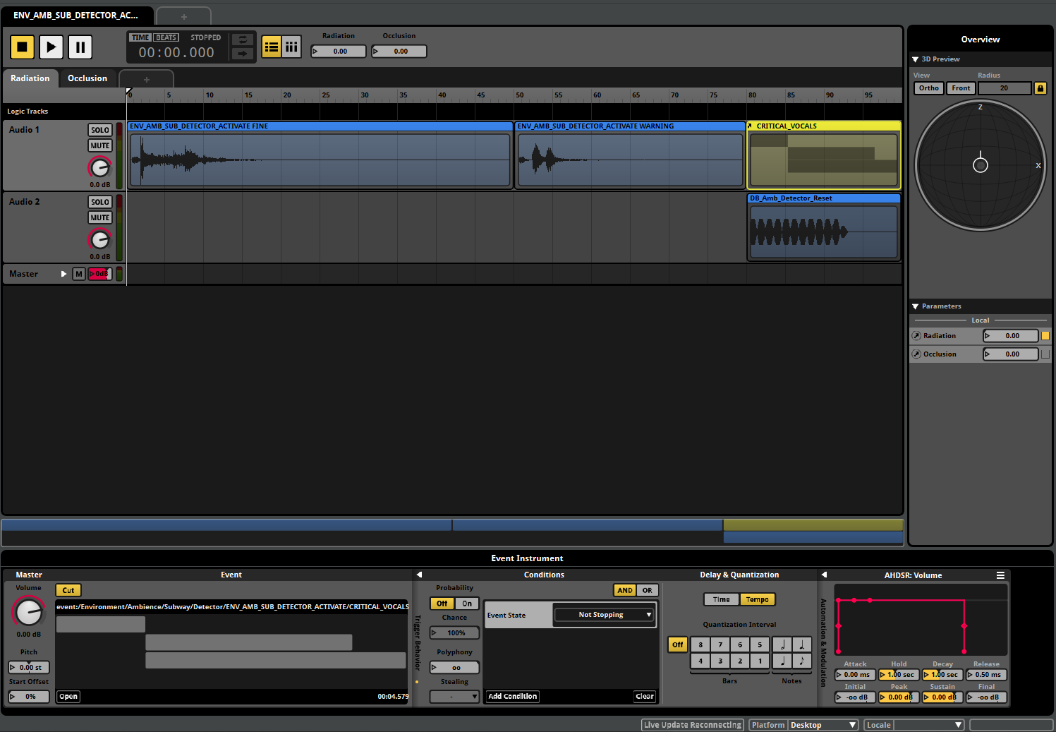

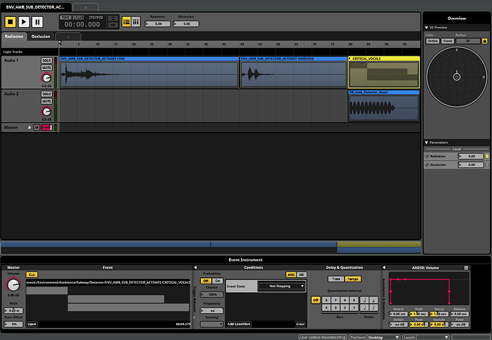

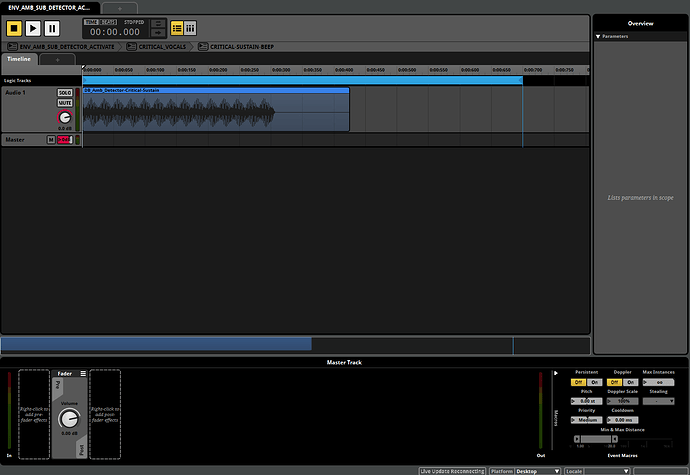

We have this event which sets a radiation level and plays a sound, there’s 2 sounds which aren’t looping and the critical sound has 2 levels of nested events which has a looping sound in the bottom event, there’s only two trigger conditions on the parent event which stops the nested when the event is stopped and plays a reset sound. Another thing to note is on any radiation value under 80 we call stop on the emitter straight away after playing so it plays out, then only call stop on a value over 80 when the detector is reset. if we don’t call stop then the event loops indefinitely.
