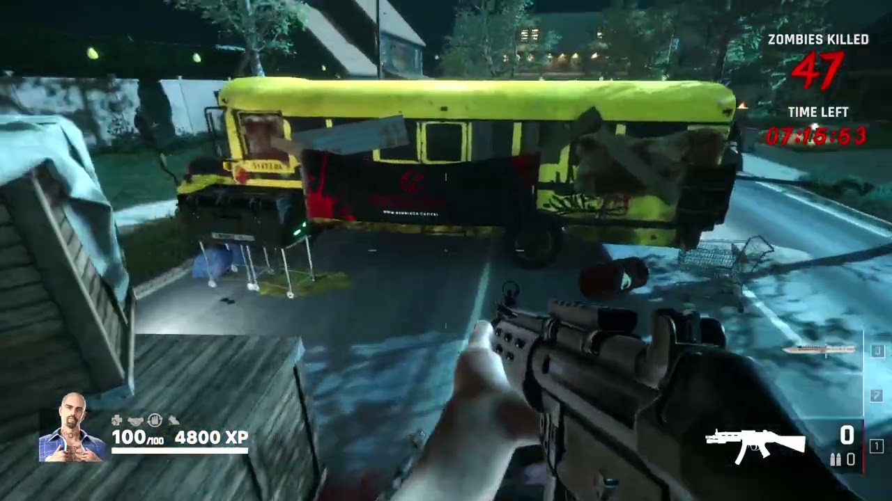

Firstly, I’ve been provided with the video by the players that have audio issues. Please take a look at it:
The problem is mostly audible with the shooting sounds. At first, they are okay but after a series of shootings, they get clipped. There are no max instances limitations and voice stealing parameters for a shooting event In FMOD Studio, so the bug is clearly something related to the voice limit.
