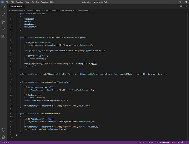

I’m also having the exact same problem on the same tutorial step. My error occurs on Step #38 as well. Where I’m supposed to “Delete the contents of the CreateSFX function.” within the AudioUtility Script. Once I delete the script lines 17-30, which looks to be the entirety of the CreatSFX Function, I can no longer Play the game and get Compiler errors.
For reference I’m on MacOSCatalina using a newly downloaded Unity 2019.4.17f1 version.
I even consulted my coder friend and he simply recommend typing “//” at the beginning of each line instead of deleting and even instructed me to do that for the same 17-30 script lines, which is the whole function he says. Still the same issue, won’t play and has Compiler issues.
I have gotten as far as tutorial set #42 as well, in the ObjectiveToast, but the same issue is present when deleting or “//” any of the PlaySound lines.
Here’s a screen shot of the function lines I typed “//”. I also deleted those same lines with the same Compiler issues FYI.:
Can I simply skip these Utility and ObjectiveToast steps so I can proceed to the parts that actual deal with Fmod and creating audio???
Typing // in C# tells the compiler “ignore everything on this line after this point”. What has happened in your screenshot is that you have told the compiler to ignore the function declaration (the public static void CreateSFX() part) but not everything after in the curly braces. Since it does not have the function declared beforehand, the compiler does not know what to do with the curly braces, and that’s why the errors are appearing.
Step 18 calls for you to delete the contents of the function. You would need to put // at the beginning of every line between 19-29 in order to ignore (ie. soft delete) the CreateSFX function. What this does is makes sure any place CreateSFX() is called nothing happens. This saves time going through all of the project deleting anywhere this function touches.

The AudioUtility.cs should look like this:
