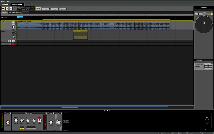

There is one that IS working: The Music Player event (that works) are sending its tracks to return tracks within the event which then have the sidechain effect applied Pre-Fader. The parameters are then being sidechained from the return tracks. The animations that are driven by these parameters still works when muting the game.
All other instances where we use the same setup the animations stop working when muting the game.
What we’ve tried/checked in FMOD:
  • Making the parameter global and sidechaining the entire bus in the mixer view (pre fader).
  • Having the sidechain effect on the track directly instead of using return tracks, still applying the sidechain pre fader.

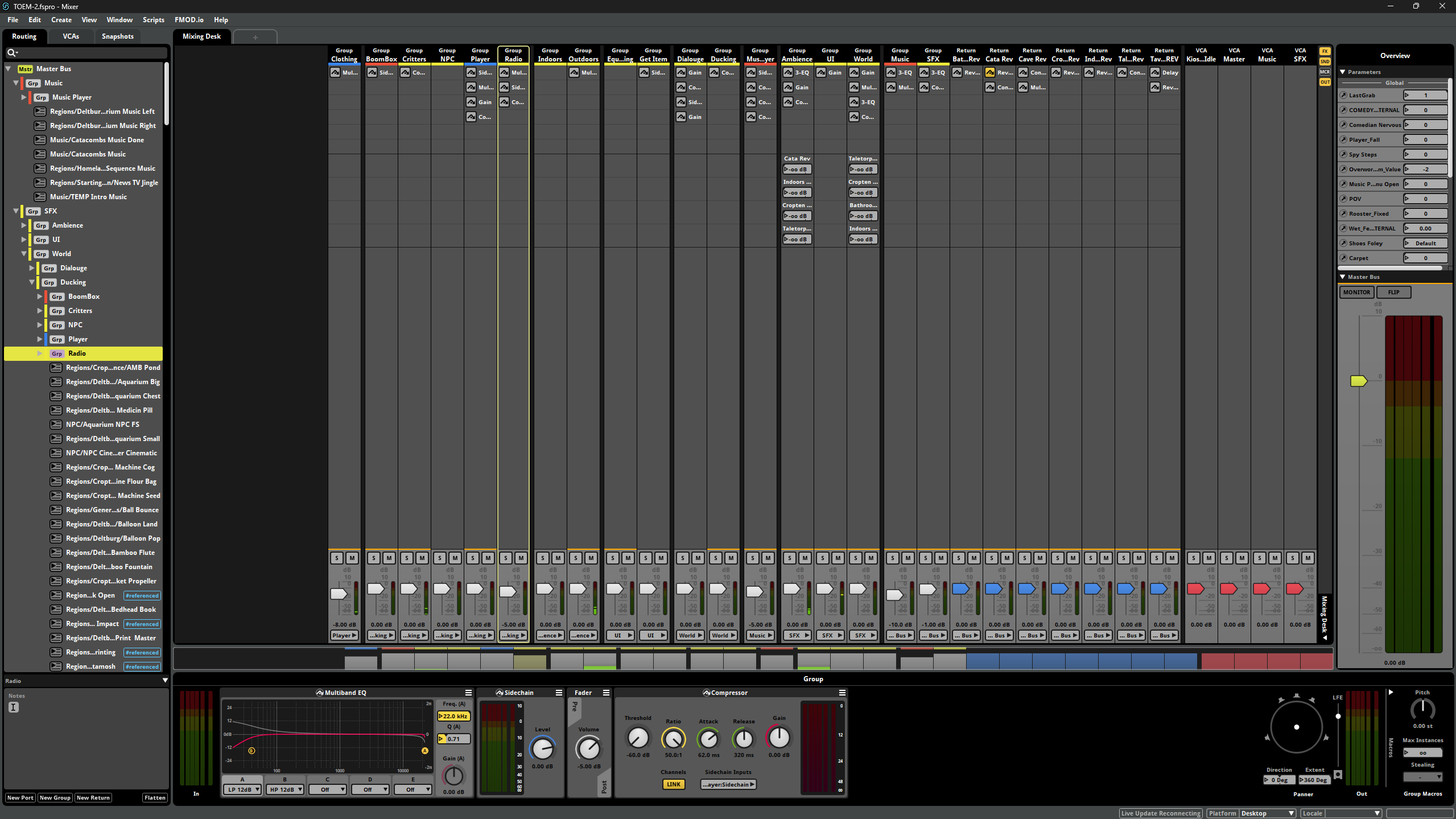

  1. A screenshot of the routing / signal flow of the “Music Player” event (the one that works)

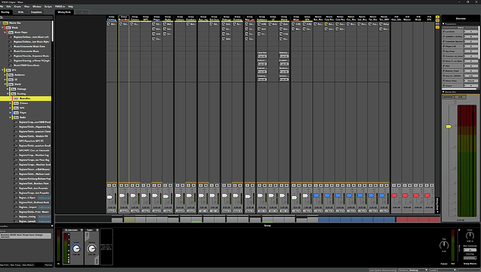

  2. A screenshot of any non-working event’s signal flow, especially where the send/return track and sidechain compressor are located?
Thank you for responding!
I hope that these screenshots shows everything you might need! Let me know if you want anything else! :slight_smile:
